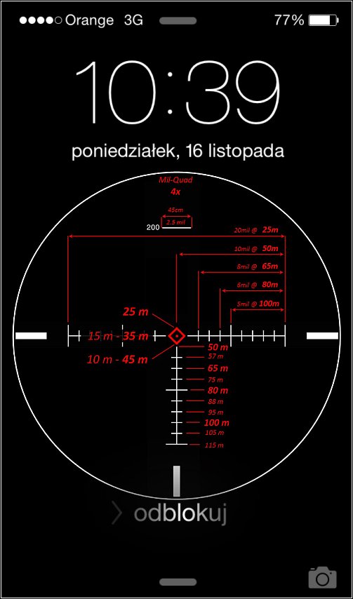

3. with help of ChairGun app I created this reticle help below. I decided to keep the 45cm/18″ target size for range estimation, which is good as it corresponds with original long-distance range marks on the reticle. And it’s also average size of a crow / ground squirrel, so I think some of you might appreciate this refference for range estimation? Don’t know but probably it’d work.

6. And this is new background on my iPhone… handy when shooting in the field:
