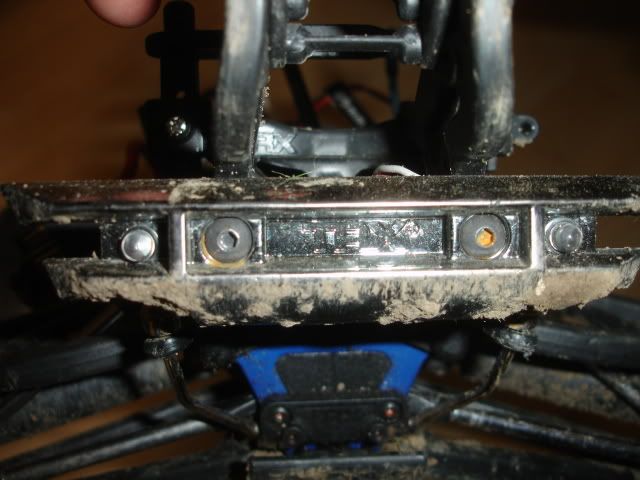

had the glue gun out…..cut the front window out and bend it back…now air comes through the window and is directed down on the motor and esc….should help cool it a bit…fine mesh should help keep debris out
cut out a grille in the back too…didnt go to well
castle creation speed control comes with a stupid grille that allows way to big chunks of stuff to get in there and jam it…so that is getting a fine mesh grille on top of it as well….hopefully this new system will last a bit longer
also added for night time driving is a light setup
rear bumber with low brakelight when driving, and high bright when braking
2 sets of front lights a set on the chassis and a set on the body…led’s are pretty bright but the system is not powerfull enough to pull even one 1W led, so im adding some 15-18K mcd white ones in time….got wiring harnesses soldered today…need a small plug that i dont know whats called….bet they have them at hobbytown usa
i need to add more lights, there should be some led’s in the mail soon…indicator LEDS, more back and front lights….maybe some ground effects for the fun of it….
